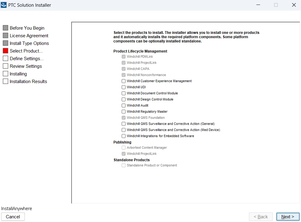

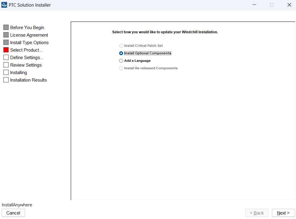

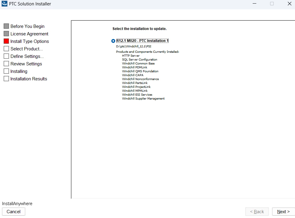

I run setup.vbs
Update Existing Installation.

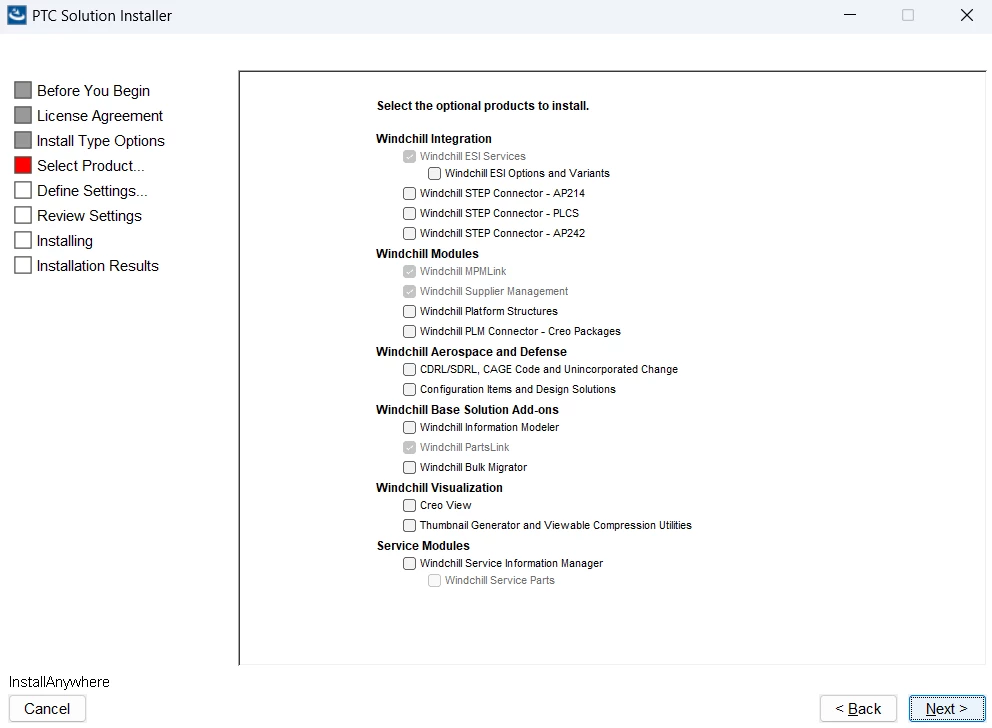

I can not find Search Index Module to Install, see

Thanks. I managed to install Index Search Module.
I was doing update existing one.
Since it was already install hence unable to check the box (Client).
To install server need to do new installation and then standalone installation.
