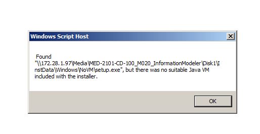

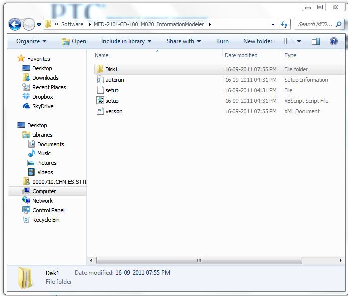

Can someone tell me where can i get the installation guide and tutorials for information modeler?
I have the setup files extracted, but couldn't see any installer application or a loader in it..

But the document you had shared is for Windchill information modeler is for version 7.0 and it's completely different from what I'm trying to work on (10.1 - M020). Also the setup file that's available in my loadable doesn't execute stating that it couldn't find a suitable java installer.
Can you please share some light on this..

Hi Amar,
The InfoModeler installation can be done using the PSI on top of an existing Windchill installation or as part of new install. it is part of Windchill base add ons during the install using PSI. As for the documentation, there is no specific documentation for this it is one of the Windchill development components that can be used for customization. Refer the WHC link for more details.
