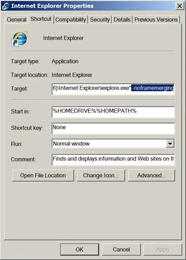

Try adding -noframemerging to the short cut that starts IE.

Command-line (i.e. shortcut)switch
If the application is being launched via a desktop shortcut, the command line switch “-noframemerging” could be added to that to get the desired effect.

I finally had time to edit the shortcut that launches IE to this...
"C:\Program Files (x86)\Internet Explorer\iexplore.exe" -noframemerging
...and that works great, too. The disabling of the Framer Merging is definitely the solution.
Disabling through the Windows registry also sounds like a sure-fire fix but I'm settling for this shortcut remedy.
Thanks to all who replied!
