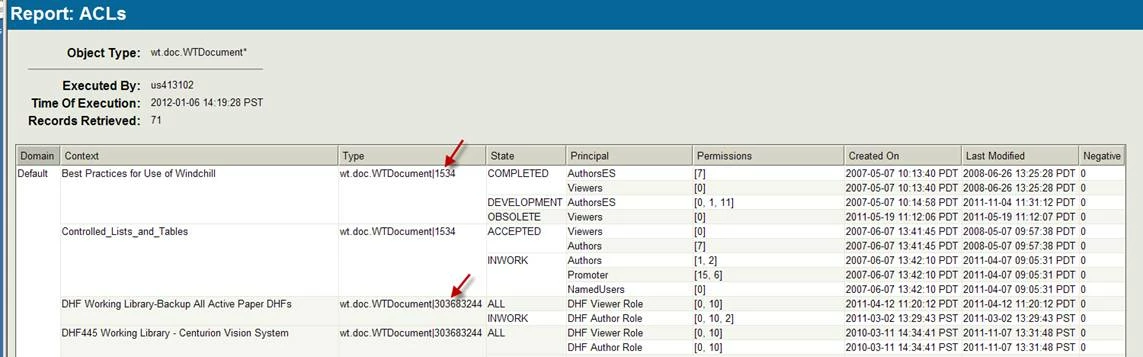

The attached query builder report also provides all ACLs in the system, along with context / created / last modified.
Don't know how long the program took to develop; the report took 6 minutes to develop.
Notes
Can filter by Type, using wildcard if desired. One downside - It reports any subtypes by their ida2a2, not the display name; need to look this up in the type def table.
Need a modified report for 10.0 because "Negative" is no longer used.
