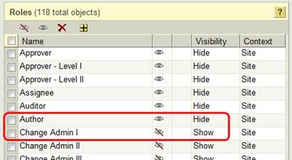

January 4, 2012
Scott,
If this role is one of the OOTB roles (you didn't edit the RBINFO file
and make additions), then check in the ORGANIZATION->ROLES tab and make
sure that the role you selected is not hidden.
Mike
