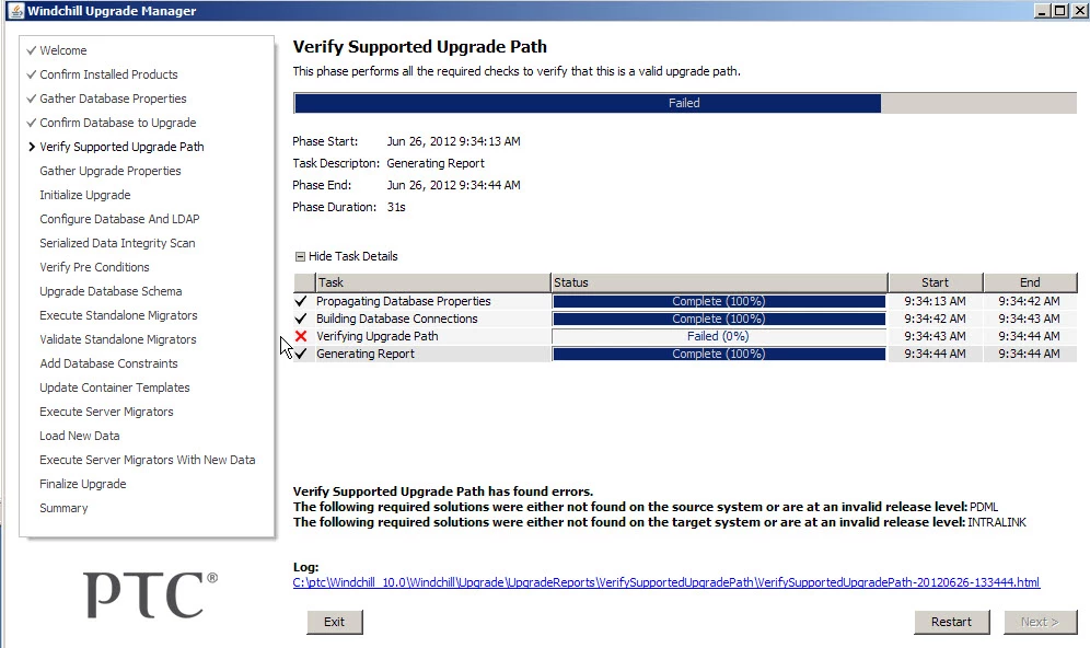

Is there an interim step required to upgrade from Intralink 9.1 M050 to PDMlink 10.x?
  • June 26, 2012
  • 909 views
I am getting an error in the upgrade manager on the 10.x targetsystem, the only thing we can think of is it needs Intralink 10, (which I didn't know existed until today?)

David, and Solutions Group,
As part of the preparation steps prior to executing UpgradeManager for the
Windchill 9.1 to 10.0 upgrade, we executed the following SQL script to
ensure the Oracle database had the correct information regarding what
Windchill modules we installed:
This SQL script got us past the Verify Supported Path task in the
UpgradeManager. You should contact PTC Tech Support about what you need
to do to make sure your Windchill Version information is correct in you
database.
