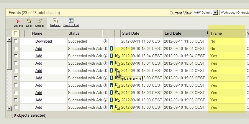

I know about the event manager but is there an option to undo an event?
Ron
September 12, 2012
Yes, there is, starting from Wildfire 5 (I think).
[cid:image001.png@01CD9104.9C505720]
But you have to enable it in the preferences:
[cid:image002.png@01CD9104.B5409E20]

September 12, 2012
Wildfire 4 + PDMLink 9 too.

September 13, 2012
yes - but only with Pro/E, and pretty sure disabled by default.
Look for the preference 'Workspace Frame Stack Size' and set a value greater than 0.
We have it set to 0 as also use CATIA, UG & Solidworks so leave it switched off to avoid confusion for users.
