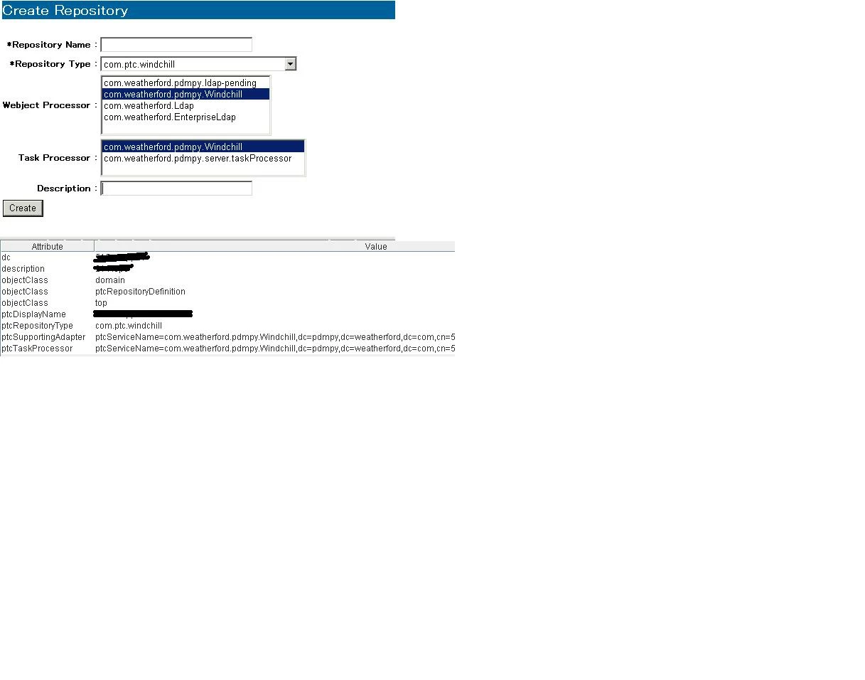

You may also need to create repository in info engine. Here's the step:
From site>Utilities>Info*Engine Administrator>Task Delegate Administration>Manage Repository
In your case:
Webject Processor: com.ki.corp.target.Windchill
Task Processor: com.ki.corp.traget.Windchill
In your ldap you should see something like this:
Let me know if you still have problems.
