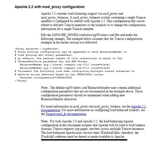

April 29, 2011
I think our root cause lies in the Apache on the Load balancer. We copied
the codebase to the Load balancer as mentioned in the PTC guide 'to make
codebase available Loadbalancer'. Are we missing something here? our cluster
has all Solaris machines. Is copying codebase not the solution?
[image: apache.JPG]
