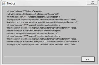

Here is the problem "wt.wrmf.transport.WTTransportException: Authentication to"
This is the url that windchll uses to authenticate to your replica server, in the log, authentication is failing as authentication is being enforced on this URL. The issue might be in the changes you made to the app-windchill-auth.conf is causing this authentication issue. Also are you using siteminder? Siteminder has also being known to cause this sort of issue, there is a siteminder file called localconfig.config that a lines in it for ignoreUrl, any url on these lines would not have authentication enforced.

Try regenerating your security key and put the new one on the replica and do broadcast reconfig.
Alexius C. Chukwuka IT Analyst, Global SAP Basis Technical Change Management (TCM) Deere & Company World Headquarters 400 19th St, Moline, IL 61265 Office: (309) 765-3133 Mobile: (319) 429-5336
Ooops, look like you already did that and fixed it.
