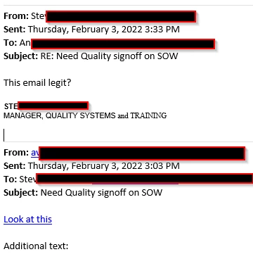

Let's talk about phishing - "Look at this"
I see this often enough to want to fix it. While we do have steps in place spot internal vs external emails, the generic-ness of the system generated emails causes people to question clicking on that link and I do not blame them. Any thoughts on how we can improve this?  It we train our users to expect these types of emails, it would not be hard for someone to exploit in a phishing attack.

Hi @avillanueva
I would definitely try to find a way how to change the mail layout sent from Windchill HelesicPetr_0-1644225511843.png if there is just a link "Look at this".
For example add a company logo, and explanation that this is from Company system.
In my opinion It is not easy, because there is not supported way how to do so.
