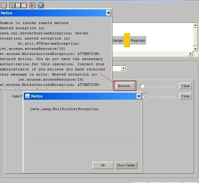

I am trying to attach a workflow to Lifecycle state. When i click on the Browse button, I am getting no access error and displaying empty workflow dropdown. I am using Windchill Admin user. Please find the screenshot in the attachment.

A few guesses:
Privelages
Make sure you have full privalges on the site. Prehaps assign yourself 'SIte Admnistrator' if possible.
Java Cache
I would also try clearing down my java cache (see attached). Java caches an ‘old’ version of the applet. When you move builds the applet may change but your browser tries to use the old version of the applet (in your previous build). This an exception because the expected version of the classes don’t match.
