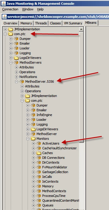

On the Server Status page, it shows a number for the "Current Active Users". I'd like to see a list of the those peoples names. Is there a way to generate a list like that? I haven't found one so far.

If you want current, you'll have to access the Tomcat active session information. I've never done but quick Google search yielded many results.

This list is available from the server manager via JMX. The com.ptc ->
Monitors -> ActiveUsers in the MBean tree and the attribute you want is
TotalActiveUsers.
You can examine this via JConsole, VisualVM, or simply by clicking on
one of the "Server Manager: xxxx@yyy" links in the server status page.
This will produce an HTML (actually client-side-XSLT-styled XML) dump of
the server manager's current MBean data. Searching for "ActiveUsers"
and clicking on that link (found in the "Table of Contents" after the
"Overview" section) will show you the attributes of this MBean in an
HTML table.

Try this:
In a Windchill Shell, type 'windchill wt.util.jmx.SMJconsole'.
Navigate as shown.

That's somewhat different in that it will give you the users who
currently have established servlet sessions with a given method server,
not the current users across the whole Windchill instance (e.g. spanning
the whole cluster, including RMI clients, etc).
What you really want is the "active users" data as per my last post.
The servlet session data is also available via JMX in a fashion similar
to this -- except from the method server and from the ServletSessions
rather than ActiveUsers MBean.
July 9, 2013
Actually you don't want to natigate to the ActiveUsers MBean under the
MethodServers for the total list.
As per the warning in the ActiveUsers results, that won't give you
cluster-wide data. You really want the more accessible com.ptc ->
Monitors -> ActiveUsers MBean in the server manager itself.
