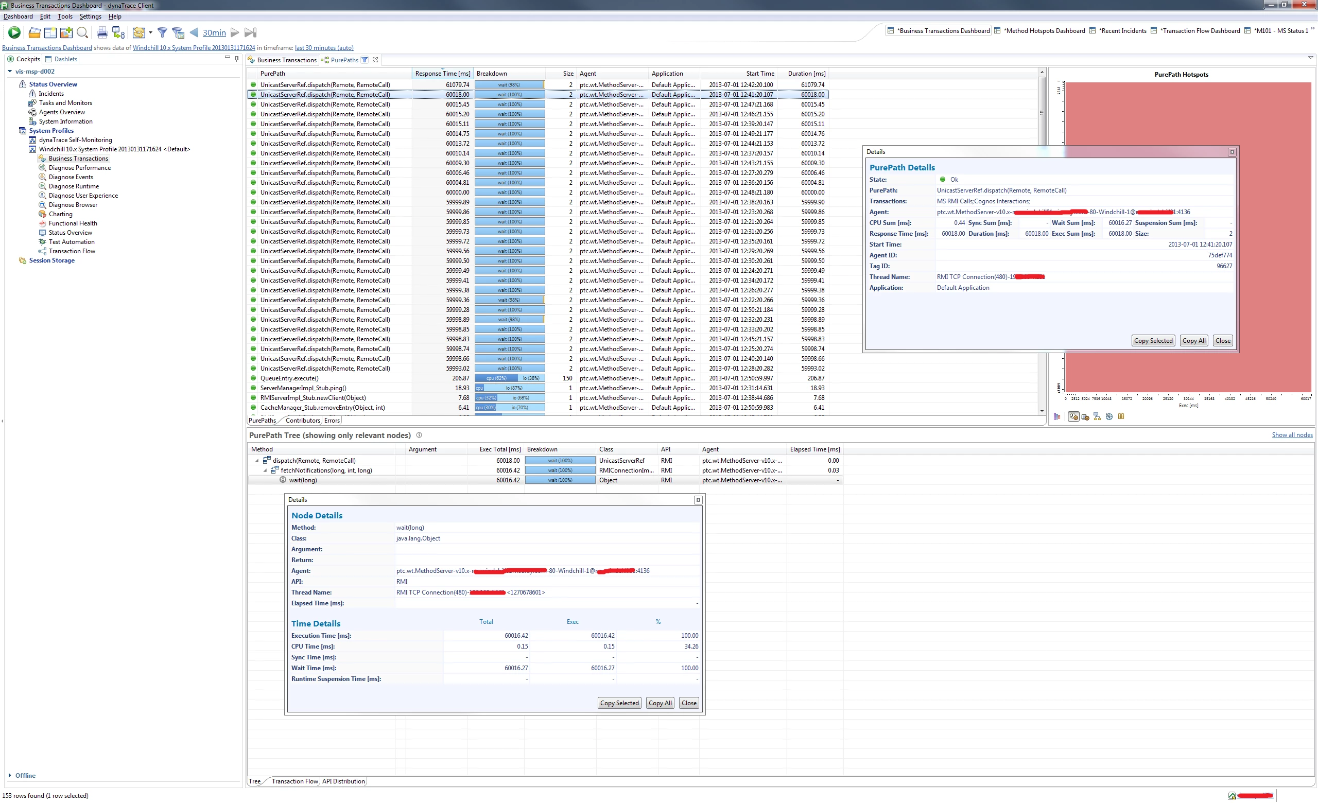

Apologies in advance for my lack of knowledge.
I've recently setup the PSM on our system, and have a question about a recurring transaction which waits a long time...60 seconds. Attached is a screenshot of the tranaction/purepath. Can anyone shed some light onto what this is causing this? It seems to happen every minute, and I don't see anything listed in any of the logs which correspond to it. In general we have no errors, but this is clogging up my system health dashboard.
Cheers
July 1, 2013
That's one JVM fetching JMX client notifications from another.
It's intentionally designed as a long-pull -- and is a built in JMX feature.
