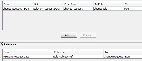

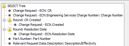

Attached are the sample report contain links between WTPart and Change Objects.
WTPart – RelevantRequestData2-ChangeRequest =Change Request’s Affected Object/WTPart
WTPart – ChangeRecord2-ChangeTask =Change ChangeTask’s Resulting Object/WTPart
Change Objects
ChangeNotice - AddressedBy2 – ChangeRequest
Hope this helps !!!
