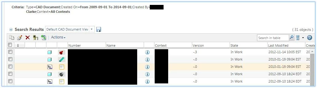

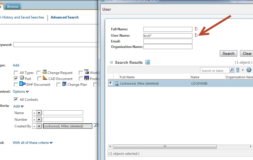

This search does not work on 10.1 M040. Thanks Tom for getting screenshot. I agree that history will show Preeti Gupta(deleted), however in our system I cannot search for what Preeti Gupta did in Windchill . We have to go to Individual documents/parts to see history. There is no way I can get a list of everything the user worked on in last 2 months for example.
September 15, 2014

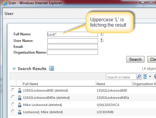

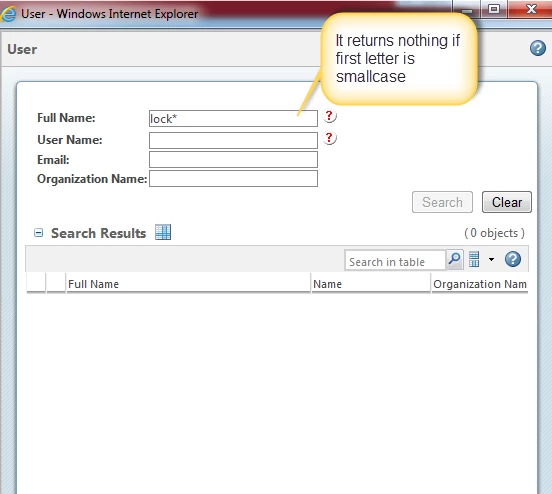

Ok, I take it back, This is funny the way this works after user is deleted from Windchill. The Full Name search is case sensitive now ...wow, I cannot believe the way it is doing it. I almost declared that I cannot search for the user once deleted 🙂
