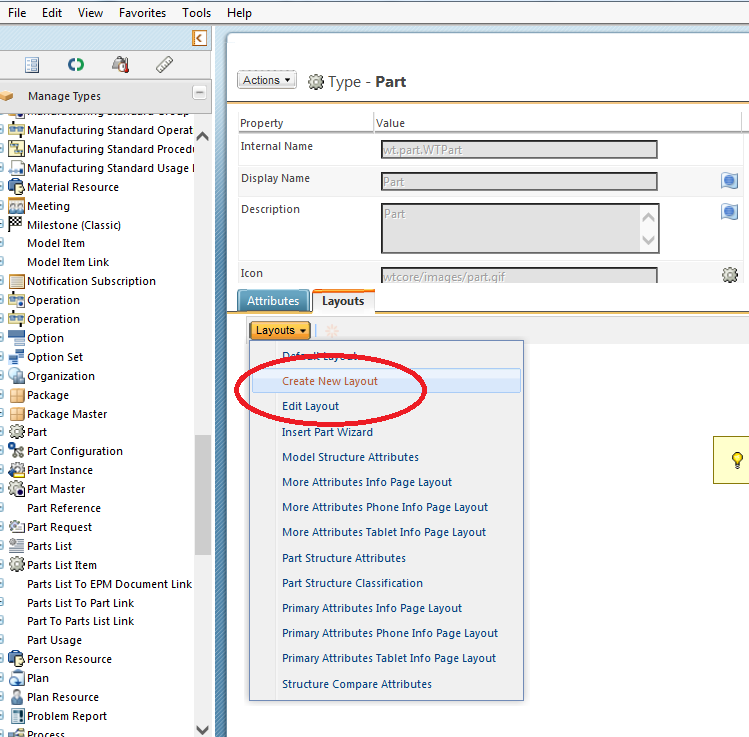

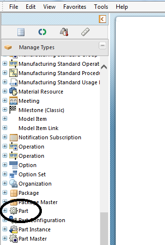

For Ben, I'll elaborate on my original post. First, go to the Type and Attribute Manager and find Part:
Then in the Layouts tab, if you want to change what users see when they are creating a new part select Create New Layout, and when editing an existing part entry go to Edit Layout:

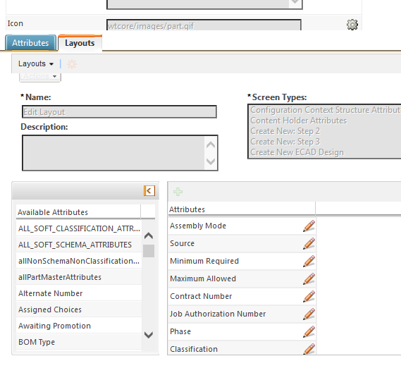

Note that you will have had to go Actions/Edit from the menu at the upper left to actually alter them. The resulting screen should look something like this:
That Available Attributes list on the left is all of the attributes that have been defined for the object (in this case the WTPart). The Attributes list on the right is the specific set of attributes you want users to see in this view, which in the above example is the Edit view. Click and drag the attributes between the two lists to switch them in and out of the view, and you can even click and drag an attribute in the right list to change the order in which they appear. Also, clicking on that little pencil icon to the right of an attribute in the right list opens up extra editing options, including Label which changes the display name of the attribute in this view (which is what Shirish was attempting above with jsp code). Once you've finished with your edits Save the changes.

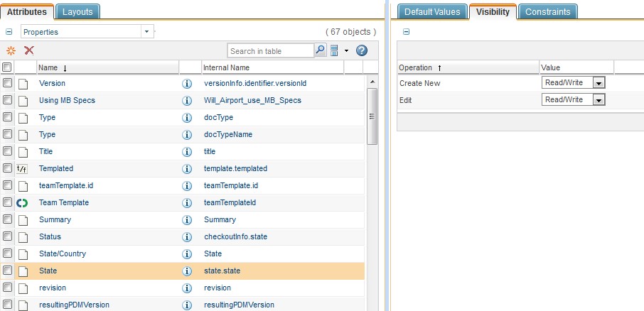

It should be in the Type and Attribute Manager, from the sounds of it from the Edit and Create New layouts. Every field the users will see should be shown in those layouts. Don't delete the attributes, just move them off from the views you don't want them to show up. I can't think of anywhere else those would be defined yet not in the Type and Attribute Manager.

If this document is a sub-type you might run into issues with trying to remove them from view as it would be using an inherited layout..in that case you'll need to hide the attribute using hide on create and edit.
