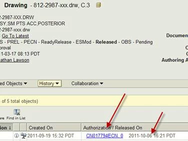

The drawing has this link to the Change Notice.
[cid:image003.jpg@01CC8507.3BB25530]
The Change Notice / Change Request includes all approvals and other user actions, each with a timestamp. Each workflow activity can be configured to require user password entry or not.
Two years ago, we had the same; today we have virtually no paper. Each day users complete between 500 and 600 Windchill assignments - appr. ½ of these are electronic approvals.
