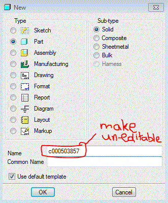

We've got the name and number working as we want with Pro/E and Windchill PDMLink, using autonumbering and the preferences below:
Upload Drop Name File Extension YES
Upload Drop Number File Extension YES
However, the name is still editable, so people could type anything in there - we'd rather keep it fixed to the autonumber.
Question: anybody know how to do this simply? PTC have described a complex-looking J-Link customisation, just checking if there's not a simpler way.

The goal here is to prevent changes to the assigned EPMDocument number.
The issue currently is that when a user creates a new model in their workspace, the "Name" field is editable, and whatever value is used then becomes the EPMDocument number on Save/Upload. The EPMDocument number should remain the assigned (C001234567) value. Any descriptive info will be going in the "Common Name" field, which then becomes the EPMDocument name.
If a particular filename is required other than the assigned number, then that update can be made after creation as a separate update. Ideally the "New" screen in Pro E should have three fields, Number (which is un-editable), Filename and Name.
Any suggestions for forcing the user to keep the system assigned number on the EPMDocument?
Is it possible to only assign the number on save/upload?

Hi Lawrence,
In our system (WC 9.2, WF5), the filename field is autopopulated with the
next available number and the engineers are instructed not to change it
(even though it is editable). This works most of the time. Usually when
it doesn't is because the engineer is uploading files created by
contractors. In this situation we renumber the files (this can be done by
renaming the file, and clicking on Set New Name then Auto Number as shown
below). The drawing Reviewers / Approvers ensure that drawing numbers are
correct (they are displayed on the drawing so it is very easy to check).

Thanks Mike and Mark for your replies.
We're pretty happy with how the Name and Common Name operate (it may be useful if these names were named differently!) - and will train people to leave the Name as-is and type the description in Common Name.
Like Mark, we may have to rely on people leaving the autonumber if we can't find a software method of freezing it.
I'm hoping Creo 1 or 2 will have an option for this, maybe find out something in Boston this month.

Now, why is ProE not showing Number and Name (and eventually Filename) in the New Window in ProE
As far as I understand it. ProE was created well before PDM/PLM. At that time of file servers. things were done by filename. Name in ProE meant filename. When ProE got integrated into PDMLink , this window did not change. Why ? I guess there are still plenty people using ProE as standalone software still.
We have been implementing sequential number and moving from descriptive number. To prevent people to change the field Name (ProE, ie Number in PDMLink) auto populated, we wrote a small little java custom rule associated with the OIR.
So technically, people can change what the system put in Name (ProE window) but will not be able to upload their file... Causing them all sort of headache,. so they do not touch that field anymore.
