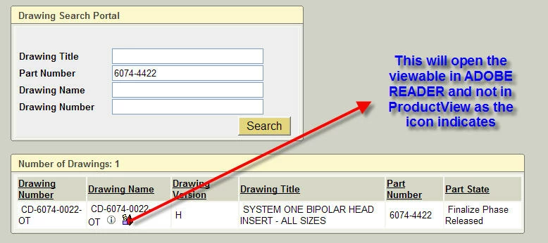

We have built something like a Search Portal (basically a simple jsp page where users can enter part/drawing number and associated object will be displayed). See attached. More over the user can view the viewable with out navigating to Windchill.

Thank you for your response. What you show is much like what we need. If you don't mind, I have some questions.
1. Do you use Windchill to generate the pdfs and, if so, are they associated to Windchill parts?
2. Does the user need to log into Windchill or does the portal manage that?
Jim
March 22, 2011
Yes, basically publisher. PDF displayed is of WTDocument (Drawing softtype) associated to parts. Our engineers upload the pdf of CAD Drawing as the
primary content of Drawing softtype. Note that our viewables are permanently watermarked.
The user will be prompted to login when search portal (as the search portal pages are in authenticated domain) is accessed but user will never have to log
in directly to Windchill.
