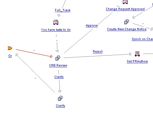

Hi Everyone - happy Friday.
I have a Process flow that I would like to modify. At the mement the CRB can add comments for Reject, Claarify and Approve.
I would like to:
A) not allow comment on Approver.
or
B) clear our the comments on the 'Approve' path.
February 16, 2013
I can't look this up now, but I think you can extend whatever the ootb taskcompleteprocessor is and clear out the activity comments there. From the workitem, you can get the actiivity/activitytemplate/process/processtemplate/etc, and clear the comments if your criteria is met.
