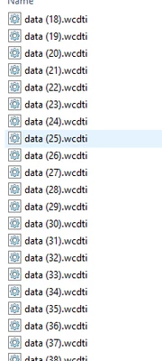

First Question: When I click on a file shown in WC’s HTML presentation of my files  (what is Windchill’s term of art for this presentation?) I indeed get a file downloaded to my computer.  However, the downloaded file has a weird name like data(2).wcdti.
Why won’t the web-based presentation of my WC files deliver me those files in the form (i.e. file name) that I originally uploaded to Windchill?
Does this mean that I must manually restore every downloaded file’s true name after using the HTML download tool?  Or that the HTML tool is not useful for downloading WC files?

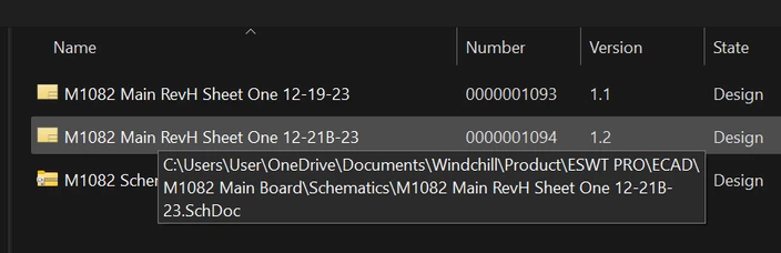

But why doesn’t Windows Explorer display the complete file name in its plugin-modified rostering of files?  It omits what old guys like me call the file extent.  This is a problem because many of my ECAD files can be distinguished from each other only by their file type.
For example, an Altium schematic file name takes the form M1182 Main Board.schdoc while the companion PCB layout file name is M1182 Main Board.pcbdoc.  The file's significance is lodged in the file type to the right of the period.
Is there a setting that will force WC's modified Windows Explorer presentation to show file type?  Alternatively, can I make the words “schematic” and “layout” be candidates for Windchill's |Type| field?

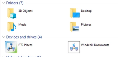

I hope this helps a bit. I have my local cache set to go to u:\Windchill pdmlink folder. There you will see a mirrored structure. Now, I can browse this folder and see my products, their folder structure and the actual files that I had opened.
Here is an example of a PDF I opened from some product in the Export Control Memo folder.
When I look at the DTI via "This PC" section, I am browsing virtualized folders directly from the server.
Notice when I go to that same relative location via Windchill Documents, I see this which is meta data about that same pdf file.
And here is showing a different "view" of that folder which I configured to show filenames.
Yes, by downloads folder is also cluttered with the wcdti files that I occasionally clear out.

The error message you're getting is from not changing the download preference in Windchill to use Windchill Desktop Integration (DTI).

First off, welcome to the party and happy New Year! Looks like you are using WTDocuments to manage your ECAD designs and also using the Windchill Desktop Integration. This is an office plugin that allows Word, Excel, Powerpoint to have Windchill menus for each check in and out. It also can add menus to Windows Explorer to make browsing Windchill folders like Windows folders. This is controlled via your preferences (QuickLinks - My Settings - Preferences) in how it downloads content. When the desktop integration is chosen, it downloads those data.wcdti files which are read by the desktop integration. Think of them like a pointer or a handoff to a local client which does the actual download. There should be a local folder when they get downloaded to which is a mirror or local cache of data in Windchill.  If you are dealing with ECAD data, might be easier to switch to basic browser to interact with Altium.  This might spawn more questions but hope that handles first.

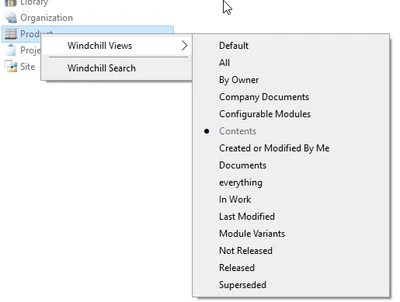

Second, yes I believe you can change how the data is viewed. If you right click on a product or library, this menu appears. Windchill Views are same as
Creating a new view is done in the folders page via the browser. Yes, filenames can be added as a column which will show the primary filename for that document object. When you return to the desktop integration in Windows explorer, your new view name should appear.

For other newbies that are following this thread, I found among older PTC training documents this direct answer to my question about the loss of file extensions when listing files using Windows Explorer file manager:
This suggestion to reclaim the file extension by hovering over it with the mouse does in fact work.  However, simply clicking on this Windows File Explorer instance of the file doesn't bring up the schematic in Altium.  You must browse to the file using Altium's File>Open command.
I found the "clicking won't open it" matter to be unusual because clicking on a non-WC instance of the same schematic file stored elsewhere on my local hard disk will indeed open the file.  I "registered" the .schdoc file type with Windows 11.
This inset image spotlights a bad habit I must change to take full advantage of WC's version control features.  I must stop endowing my file names with creation dates and revision letters.
