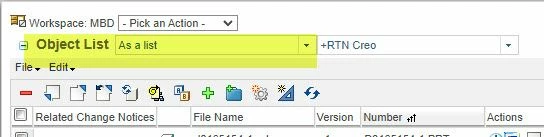

Maybe a silly thing but one I do see often:
Do you have any "search in table" filters going that are filtering out the data?
Are you on a table view that doesn't show that data type in your workspace?
Are you in the right workspace?
Assuming it's not something simple and the files were in fact in your workspace but now aren't (and you're in Creo) you can recover them with the recovery utility but that also assumes some sort of cache corruption that needs to get sorted out.

Apr 26, 2023 7:22 PM UTC
We run it to this all the time assisting users. Our main culprit is they accidently changed their table filter. Make sure it is set to "As a list".
