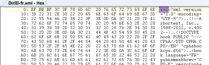

Windchill 10.1. We are trying to open xml files in a text editor (i.e. TextPad) in order to view as "HEX". We need to look at the source in order to troubleshoot issues (i.e. view junk characters at the top of xml, see attachment). Currently we are saving the files outside of Windchill and then opening them in TextPad as HEX view.
Anyone know if this can be done within Windchill?
