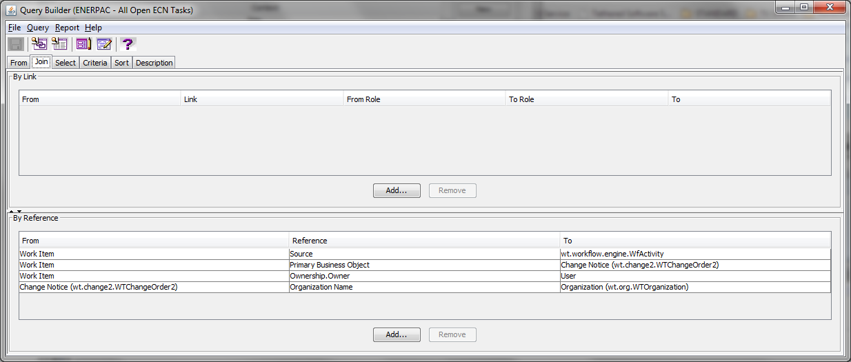

Anyone know how to create a Report Manager report that will return all Open tasks by User?
I created a report to show all open CN's that are "Under Review" - but I don't seem to be able to connect that to the un-completed Approve Change Notice task.
Cheers,

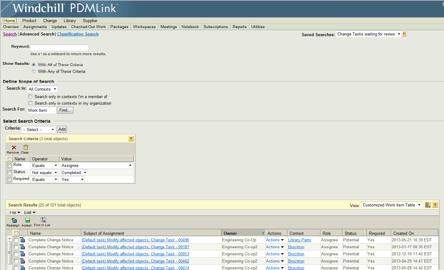

May 31, 2013
Will the results shown in the image below provide you with the information you need?

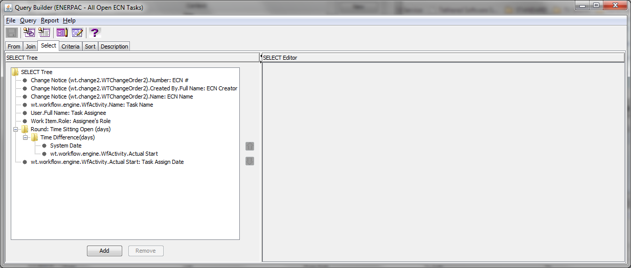

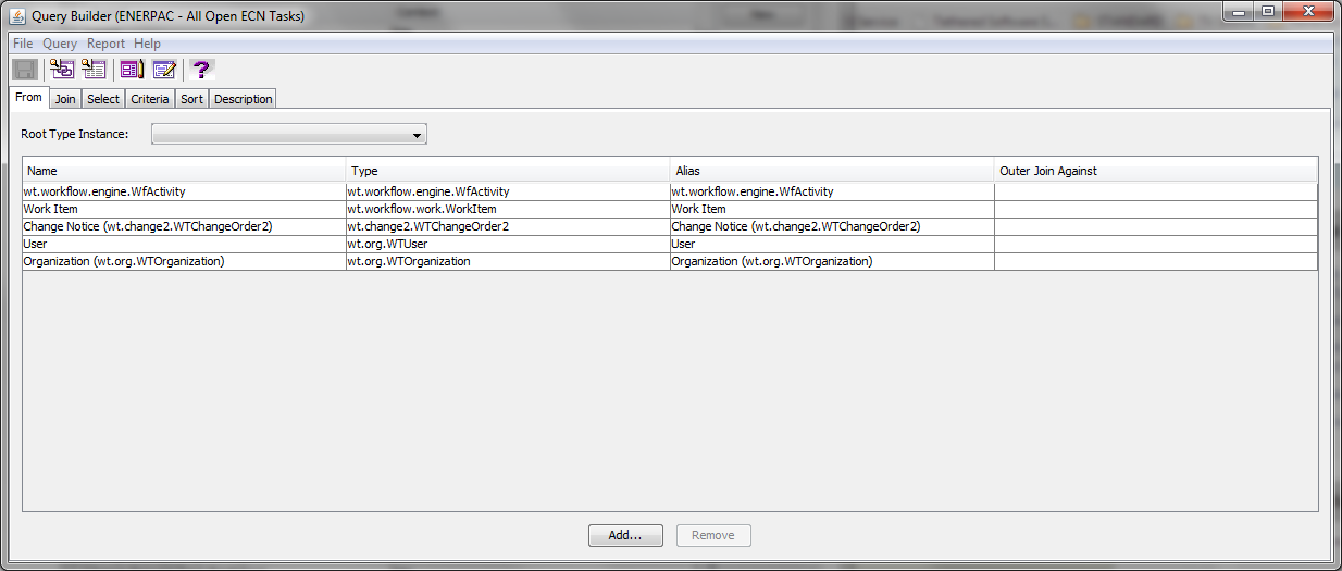

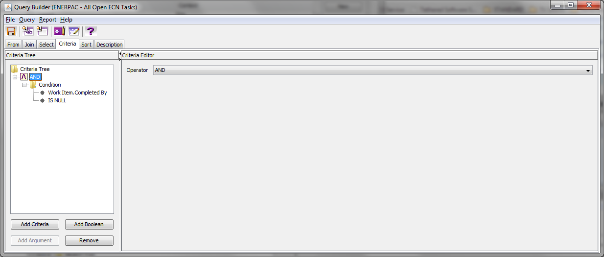

Ladric,
Perhaps this QML will be useful. It looks at all tasks assigned from a Change Notice. I have a QML for Change Activities too. Furthermore, you can set this report up properly so that any user can go to Change > Change Monitor and pull this report. I'm not sure how to attach a QML file, so screenshots will have to do.
