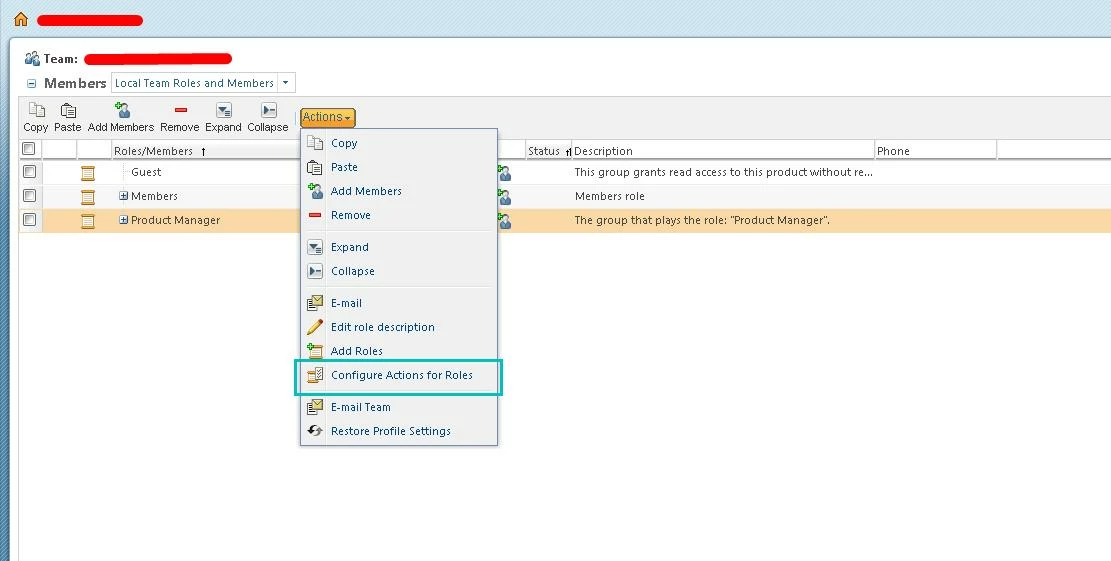

April 28, 2014
you can use "Context > Team > Action > configure Action for role" to hide action only for one context. see attached screenshot.
Hope this helps !!!

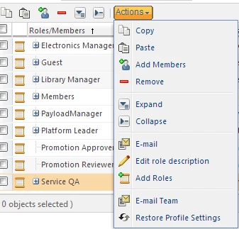

April 29, 2014
[image: Inline image 1]
Atre
Some how i do no see that options what you mentioned.
Any settings to view it?
Regards
Giridhar
