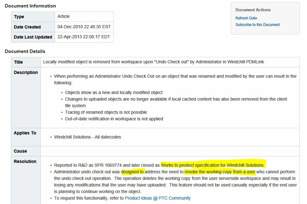

egifford12-AmethystAuthor
October 8, 2013
Intended functionality / works to product specification - nice. PTC might want to change it to make removal of the object from the user's workspace an option instead of the default behavior, or at least change the name of the command.
Here is the wording from PTC (attached). Basically, use the admin "undo check out" cautiously as it is actually "cancel check out and remove from the workspace of user that had it checked out"
I've created a Product Idea under Windchill on the PTC Community page to have this function changed. http://communities.ptc.com/ideas/3311
