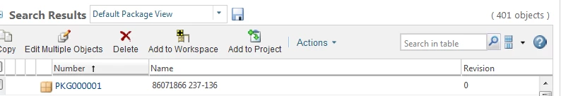

We started using Packages in the past few months - very simple to start. Have created just over 400 so far. Using for sort of a non-standard need - to manage the data going to a vendor and other preparation the first time any component is purchased.

- You can configure saved searched for this type; very handy. Query Builder Reports also.
[cid:image006.png@01CF8C94.87FEB9A0] [cid:image007.png@01CF8C94.87FEB9A0]
