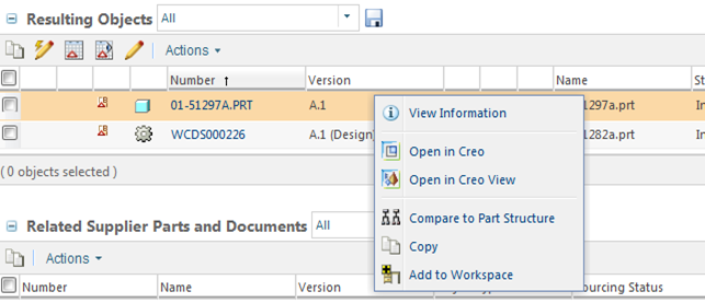

February 17, 2014
In 10.2 M020 we will have an Add to Workspace action from the Affected and Resulting tables. This will allow users to quickly and easily get data from their changes to their workspaces. Round tripping (identifying on check in which change to relate to) is something that we would like to do in the future as well.
