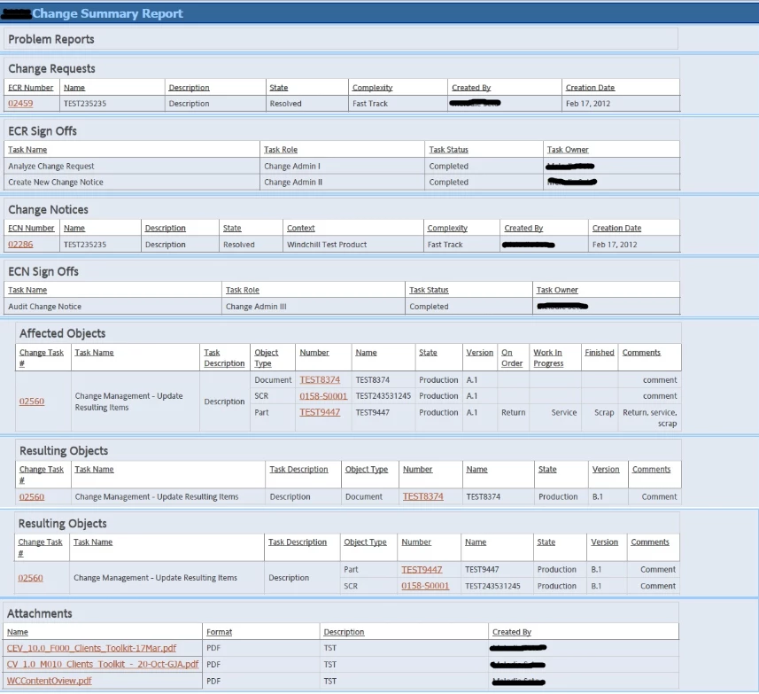

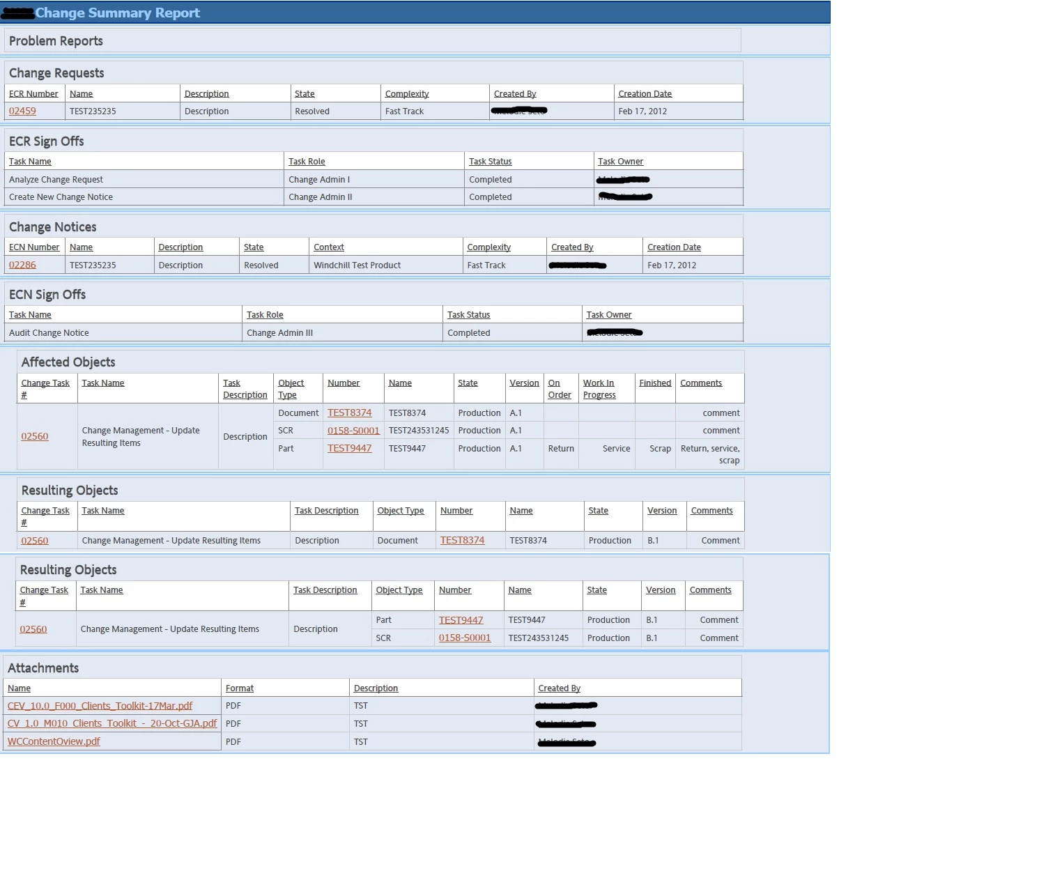

April 18, 2012
I built a Cognos Report for that. Go to actions on an ECN and select Change Summary Report or right click "Summary Report" if in WC10. From here you can print it or export to various files (PDF, Excel, HTML).

April 18, 2012
Steve's OOTB report should be used if your users are ok with it. See my
2010 presentation if you need to something custom.
April 18, 2012
My report isn't OOTB. I had to build using QB and Cognos. WC10 does have OOTB reports though for this kind of stuff. They *might* fit your needs but you would have to check.

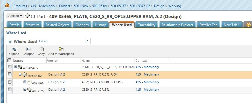

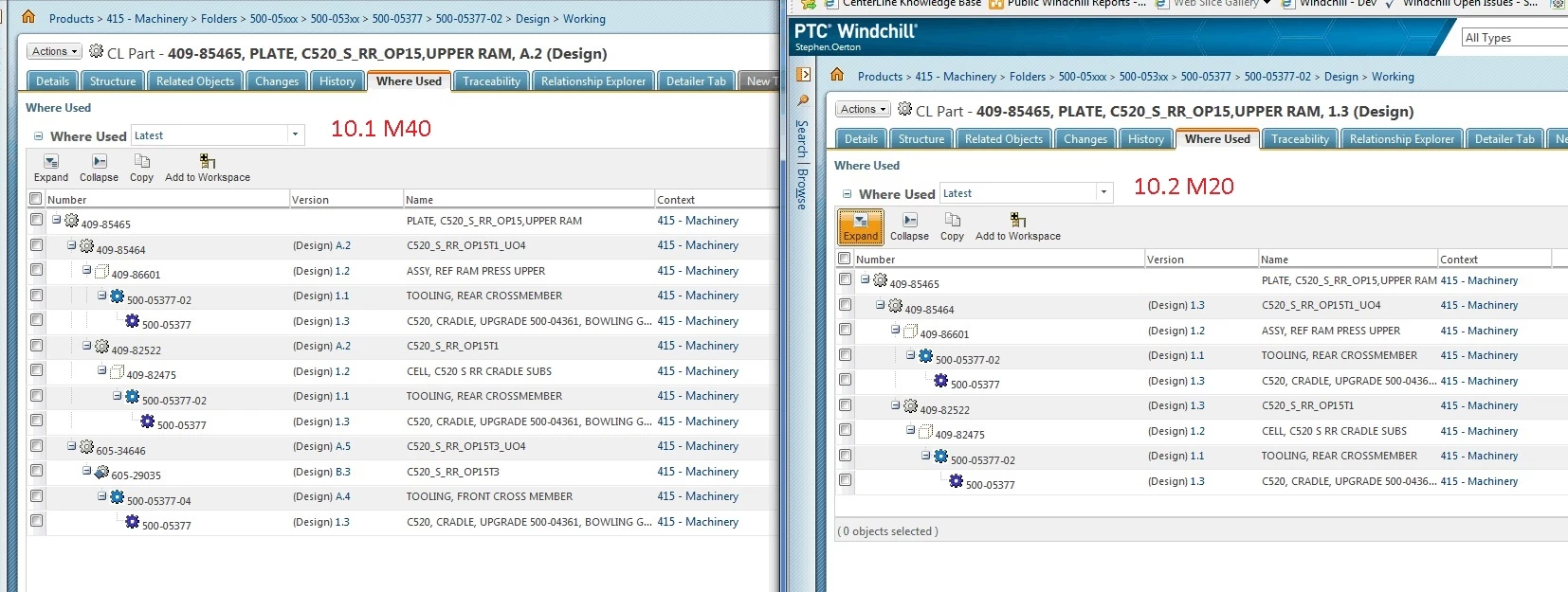

August 15, 2014
Was just testing 10.2 M20 and when I switched the drop down to Latest, it didn't show the non-latest object (See attached image Whereused.jpg). Can anyone else confirm this is functionality or fluke?
My 10.2 environment is a test environment with a partial data set.

September 15, 2014
After our full switch to 10.2 last weekend, I think it was a bug in 10.1 that has been fixed in 10.2 (see attached screenshot)
