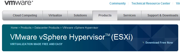

I think your confusing ESX and VMware Infrastructure. VSphere is VMware's new management infrastructure for both ESX and ESXi. VSphere replaces VMware Infrastructure not ESX. ESX is a custom version of Red Hat Linux from VMware used to run the VMware hypervisor. ESXi is a new smaller footprint OS designed by VMware to only run the VMware hypervisor. ESX is being phased out in favour of ESXi. Here are a few links to help clarify the different products from VMware.

I apologize if I misinterpreted your original post. To me your comment equating ESX with vSphere without an explanation could confuse new VMware users. Having sold VMware I'm sure your familiar with VMware's history, but I'll include a little history and why I believe saying vSphere was formally ESX is confusing.
ESX is a hypervisor while vSphere is a virtualization infrastructure platform. Your correct, back in the ESX 1.X and 2.X days all the VMware enterprise products were referred to under the ESX name. However, starting in 2006, with the release of VMware Infrastructure, the role of a hypervisor was separated from the management/infrastructure layer and ESX become a component of VMware Infrastructure. In 2009 VMware released vSphere as the replacement to VMware Infrastructure. I don't view vSphere as formally ESX because ESX still exists as a hypervisor for both VMware Infrastructure and vSphere. I've seen many new VMware users become confused by statements like "vSphere replaced ESX", as the statement doesn't explain how/why ESX still exists. VMware moved from selling hypervisors (ESX etc) to selling virtual machine management infrastructure (vSphere). Today everyone (VMware, Microsoft, Red Hat, Citrix, etc.) gives the hypervisor away and charges for the management infrastructure. There is a distinct difference between a hypervisor and the infrastructure platform used to manage the hypervisor(s). This difference could be lost if you equate ESX with vSphere.
I don't understand the point you were trying to make with the link you included. The link is for a free download of the VMware ESXi hypervisor, which was recently renamed to VMware vSphere Hypervisor. The new name isn't perfect, but it better describes the product being delivered. You get a standalone ESXi hypervisor and the vSphere desktop client to manage it. The reference to ESXi in the old name was huge point of confusion. Your really getting a single node vSphere infrastructure.
Here is an expert from the FAQ on the link you sent.
What is the difference between VMware ESXi and VMware vSphere Hypervisor?
VMware vSphere Hypervisor is the new name for what was formerly known as VMware ESXi Single Server or free ESXi (often abbreviated to simply “VMware ESXi”)...
