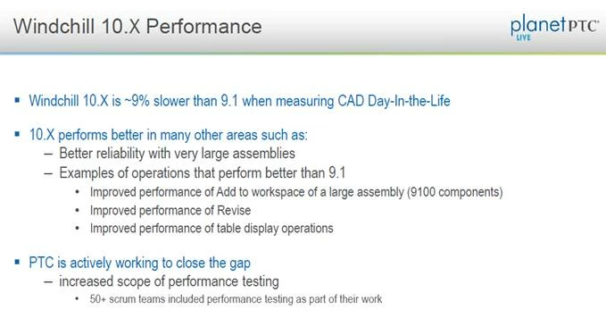

June 15, 2012
There was a talk by PTC at the conference. This is one slide from that slide deck. I wish it was one of the talks I'd had time to attend as there is a lot of good info in the slides. The talk was called "Windchill Architecture Primer Part 1"
[cid:image003.jpg@01CD4AFB.E0F60A40]
