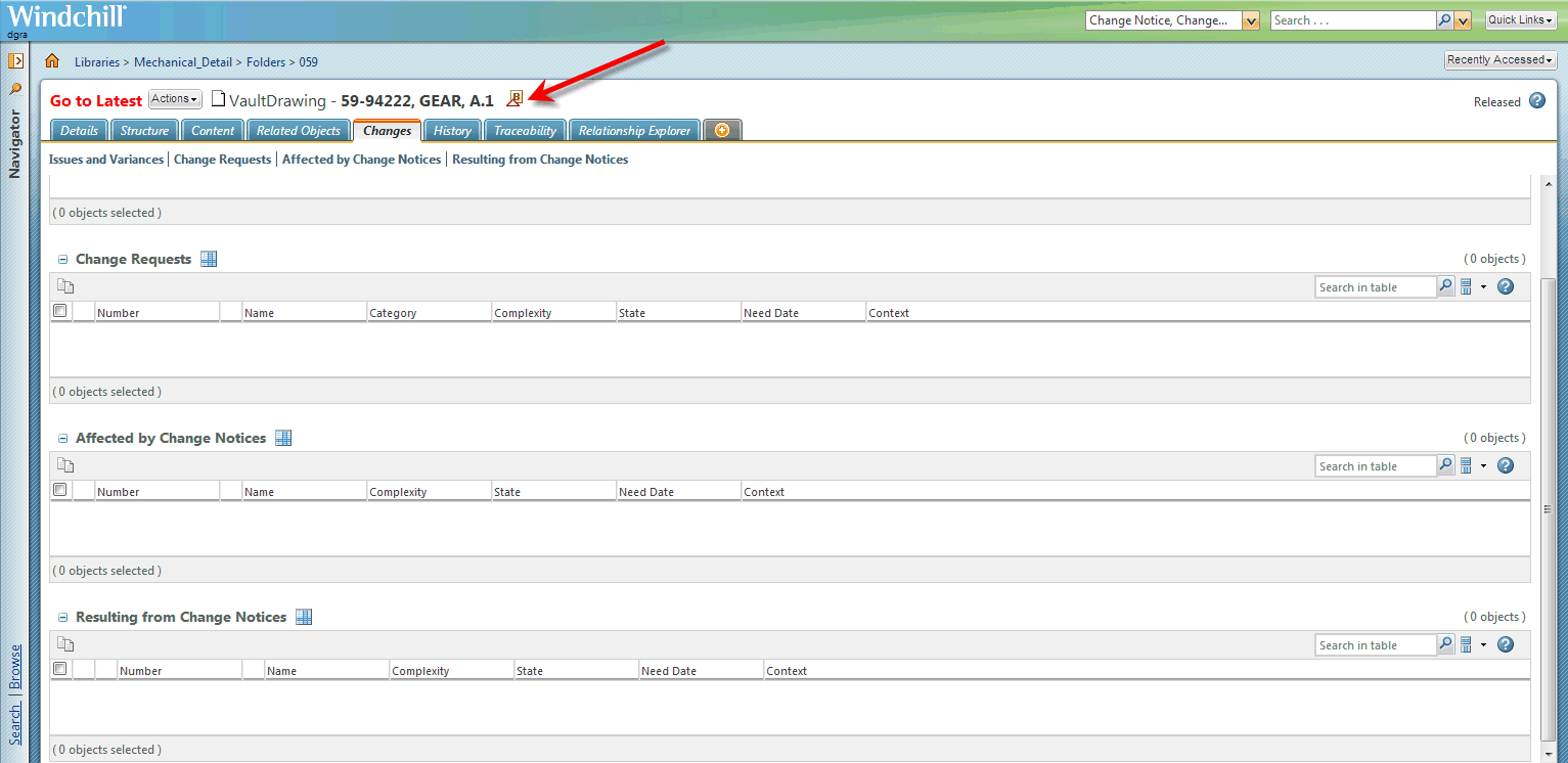

Anyone seen this before.
Pending change icon displays even though there is no pending change
objects association.
I queried our dB and found 137 such cases.
I know how to remove the icon but I though this behavior rather strange.
PTC has not been able to offer an explantation.
10.1 M010

I saw the same thing in my 10.1 M010 system. I couldn't for the life of me find any pending changes that caused this. How did you remove the icon?

First whether the icon appears or not is determined in the dB tables
WTDocument, WTPart and EPMDocument.
Run describe on WTDoc, WTPart or EPMDoc. All three have columns that
determine if the icon is displayed.
In the image below I point to "HASRESULTINGCHANGE" column.
Value for this column is either 0 or 1 (it is either a resulting item in a
Change Activity or it is not) I was only concerned with resulting items.
Affected Data would be a different column but I think you get the idea.
For the purpose this mail we will focus only on Resulting Items.
Sadly my SQL is not great therefore to solve at the dB level I did the
following.
I spooled the output of every WTDocument where HASRESULTINGCHANGE=1 to a
text file. We will call 1.txt
select ida2a2 from WTDocument where HASRESULTINGCHANGE=1;
I then wrote a Java script to read my spooled file and write an sql script
that finds ida3b5 from ChangeRecord2 where ida3b5=<the ida2a2=" from=" the=" <br="/>WTDocument>
A ChangeRecord2 is nothing more than a link that connects a Changable to a
Change Activity.
This would return all legitimate id number where HASRESULTINGCHANGE=1
select ida3b5 from ChangeRecord2 where ida3b5=<the ida2a2=" from=" the=" <br="/>WTDocument>;
I then spooled the output from my sql script to another text file. We will
call 2.txt
1.txt has all id number of WTDocs where HASRESULTINGCHANGE=1
2.txt has id numbers of all legitimate WTDoc where HASRESULTINGCHANGE=1
I wrote another Java method to compare the two files and output a second
sql script.
Any number that is in 1.txt that was not also in 2.txt needs to be
changed. When my method found such a number it wrote to the second sql
file
update WTDocument set HASRESULTINGCHANGE=0 where ida2a2= <the number=" that=" <br="/>was found>;
I then ran this second sql script and problem was gone.
