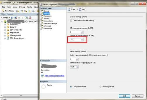

Assisting a customer Windchill 9.1 M060 Server with SQL Server;
Standard Performance Improvements, Apache, Tomcat and Windchiil (2 MS, 1 BG) in Place. Decent Memory Settings.
