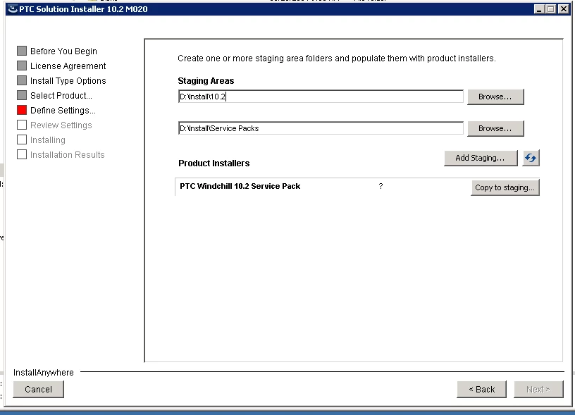

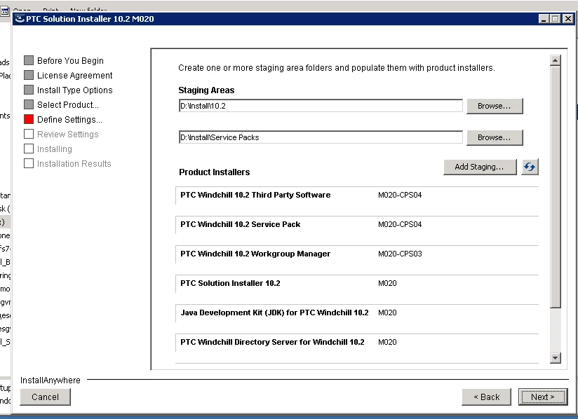

Correct, the attached screen shot (staging.png)shows the current view, while staging initial.png shows it during the first install. The Copy to Staging does not see any Product Installers, but it shouldnt need to(right?) since they are already in both staging folders. Thaks for your help.

The product installer it is looking for is the installer that comes with the cps04 download. You
need to extract the cps04 download into its own directory and then use that directory as a (2nd area
in your case) staging area. If you have other cps's in your d:/Install/Service Packs directory this
will cause a problem with the installer.

Right, it's already in the 2nd staging folder shown, D:\Install\Service Packs. That folder only contains the CPS04 files.
pcnelson1-VisitorAuthor
October 22, 2014
Yes, the command I am running is D:\Install\Service Packs\PTC_Solution_Installer_10.2\setup
I tried renaming the folders to allow adding them back with the renamed the cpsxxstaging area 1st and the original install staging area as the 2ndstaging area. That allowed me to add the installer files to the cps staging area but after that it was still stuck., as if it was looking for something else. The program can apparentlytell that the CPS was run before because the Add Additional WorkGroup Managers selection is grayed out when it comes to thestep to pick Install CPS/Add WGM/Install Optional Components/etc. There must be a setting that tells it the CPS has already been run.
