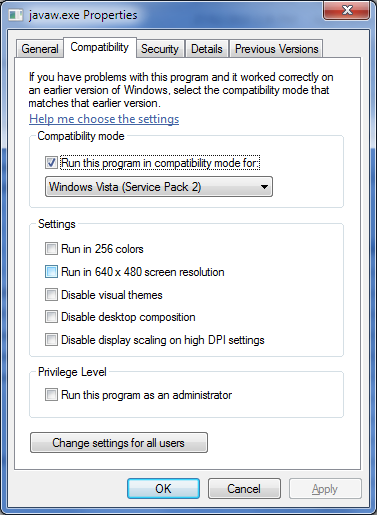

First, to get the Pro/INTRALINK client to run under Windows 7, you need to change how the embedded java executable runs. The version that comes with Pro/I 3.4 is old and not supported under Windows 7. So if you run it in compatability mode it will work.
  • Go to the <proiclient>\i486_nt\jre\bin\ folder and select javaw.exe
  • RMB and select Properties and select Compatability
  • set it to Windows Vista (Service Pack 2) as shown
Now Pro/INTRALINK 3.4 M062 will run.
