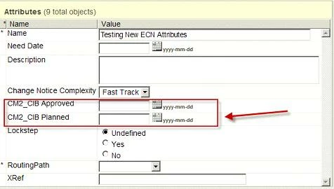

Does anybody know a way to add a date attribute as a soft type with a default blank value? The value defaults to today's date, which is not desired since we would like to use these attributes as-forward looking dates.
The only other option we have found is a System Preference called 'Default Value Display Mode' under 'Attributes' section of Site > Utilities > Preference Manager. However, setting this Preference to "Do Not Display" would set all the Attribute Text Boxes, to display a 'Drop Down Text Box' with a blank value as default. Regarding the Default Value for Date Attribute in Type And Attribute Manager, it is not possible to keep a blank value in the beginning.
Any guidance would be much appreciated!
