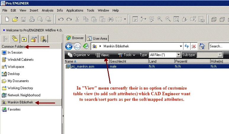

Hi Team,
Currentlywe areusingPro-E Version 4.0 M170.We have custom attributes added to Pro-E CAD files (common attributes) which are mapped with Windchill attributes. Our CAD users face hard time to search CAD parts using these common attributes as the ProE-Windchill embedded browser (version 4.0) fails to support customized table views functionality.
Due to this limitation CAD engineers find it difficult to quickly search CAD parts using attributes (common attributes) in Pro-E session.
In Windchill users can add custom/soft attributes to the table view. Wewant similar feature to be implemented in Pro-E embedded browser "View".
Is this possible? How to do it ? Has anyone come accross such scenario ?
