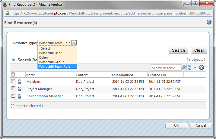

Hello Community
Does somebody has experience to assign a role to an activity and not a teammember?
We would like to create template projects where we can define the roles on the team page and then several activity were assigned.
Anybody can help or has similiar topics?
Thanks for your response.

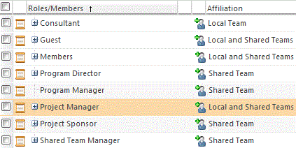

Does attached address the need?
Using this now with multiple clients.
November 4, 2014
Here, you may use shared team as shown below from Project.

Role based assignments are coming in Windchill 10.2 M030. When assigning resources to a Plan event (Activity or Milestone) you'll be able to chose from Windchill Group or Windchill Team Role. Activities will still only have one owner. This change is regarding resource assignment.
