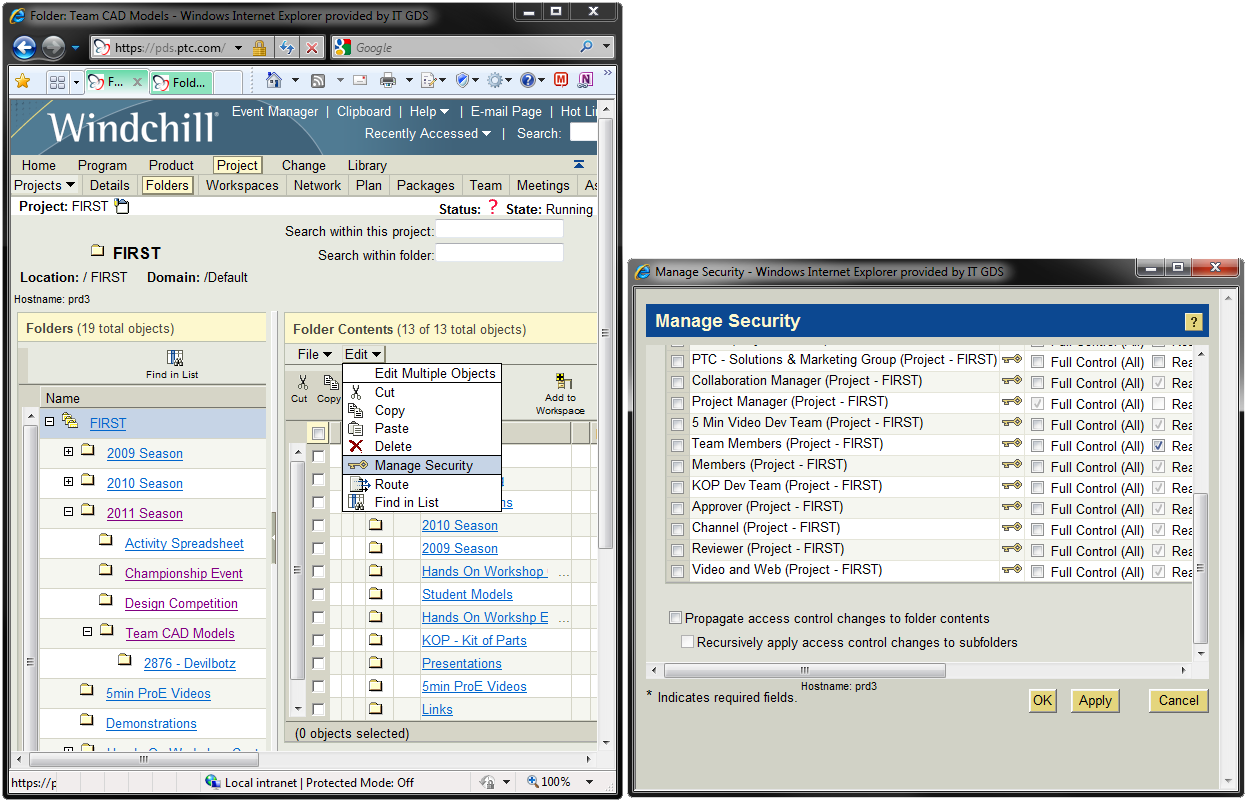

When I add a group to a project I would like to be able to limit folder access. Example I have outsourced design work and only want them to be able to see in a cad model folder and not the folder that has the budget info in it. I have tried creating a group, a role. No matter what I do they end up with complete access. Any help would be great. I thought this was straight forward, but I was wrong.

Assuming you are in Windchill 9.1, once you have the Roles defined, you need to go back to the folder list and apply the Security Settings you'd like to have. This is done with the Actions menu for each folder or the Edit menu for all folders in the project.

That is what i have been doing but it does not seem to stick. When I add my new role to the team it does not allow ne to change anything.permission.GIF
April 25, 2011
There are many conditions that could be controlling your ability to chance the access settings and many of them are defined in the Help Center until the topic titled "Understanding When You Can Modify Permissions". Another quick check you can run is to uncheck the permissions you'd like to change from the Team Members role and clicking Apply. This should unlock the other roles allowing you to control them individually.
