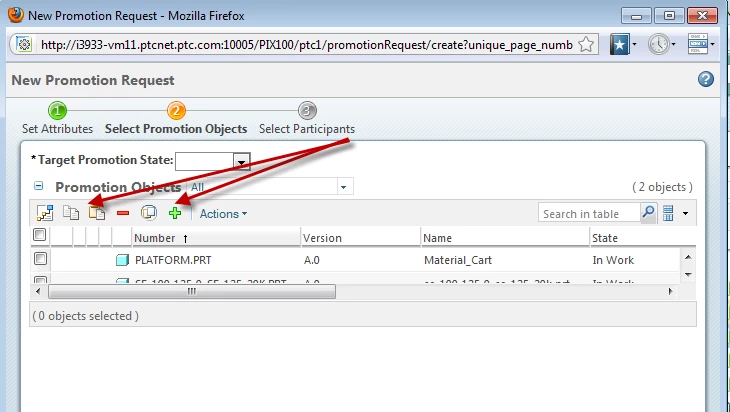

While doing some testing, I noticed that the promote action is missing on all action menus, even for wcadmin.
I found this TPI that seems related:
https://www.ptc.com/appserver/cs/view/solution.jsp?n=132911
However, I don't know what the TPI means when they say a "blank" template.
When I created all my products and libraries, a template must be selected
In the past, was this possible to leave it blank?
Per the TPI, I did create a product using an OOTB template. Promote action is availble for that product.
But that does not explain why this is happening. I would assume a policy is at issue.
And it does not explain why wcadmin cannot see the promote action.
The product/library templates that I use were derived from the OOTB templates.
All policies were removed from the product/library domains of my templates.
All my policies are defined in the PDM domain of the Org becuase we want eveything to work identically (by team membership) in all libraries and products. My PDM policies are identical to what was in the individual products/libraries. (or so I beleive)
All other aspects/permissions appear to be working properly. Only problem is the missing promote action.
Set state is OK as well.
