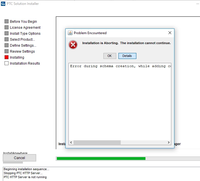

Hi All,
I am trying to install Windchill 11.0 M030-CPS11 on Windows 10 machine. I am getting the attached error and the installation is then getting aborted.
I have seen a PTC Case where it was said to run the below command
xconfmanager -s wt.db.maxBytesPerChar=3 -t codebase\wt.properties –p
But even after the property value got changed the installation is getting aborted. The PSI Installer error is as below
Updating database schema... be patient.
Java HotSpot(TM) 64-Bit Server VM warning: ignoring option MaxPermSize=128m; support was removed in 8.0
joining with std out thread
std out join complete.
joining with std error thread
std err join complete.
AddColumns -u -s process returned non-zero: 1
Installation is Aborting. The installation cannot continue.
Aborting installation.
Error during schema creation, while adding columns. See the logs for more information.
aborting: original exit_code = 2
aborting: normalized exit_code = 2
SHUTDOWN REQUESTED
commiting registry
(X) shutting down service manager
(X) cleaning up temporary directories
Exiting with exit code: 2
cleanUp()
calling cleanUpWin32()

Jul 25, 2019 8:05 PM UTC
This appears to be an intermittent issue.  I've seen it in a couple of 11.x installations so far.  It throws this error when I run through the installation picks and walk away -- assuming it will complete eventually.  Rerunning the PSI doesn't help.  It is terribly frustrating because the only/most expedient solution I've found is to delete the installation and start over.
It will complete successfully if I sit there and interact with the screen occasionally.  I haven't logged a call since it isn't repeatable, has only happened twice over the last 4 months, and time is critical when it happens.
Anyone else found a way to fix/prevent this?
