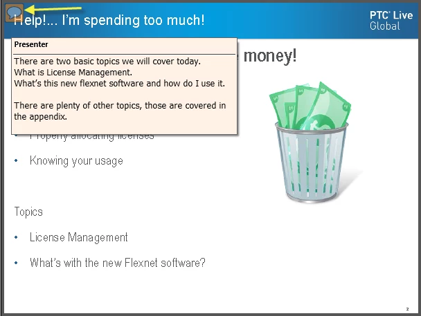

The way I approach my presentations is I'm creating documentation for myself and others in my company. I want this presentation to pretty much stand alone and be a reference document.
I've won three best presenter awards, so I'm pretty sure most of the attendees like the detail I put into my talks.
The way I strike that balance of not overwhelming the audience is to only show one bullet point at a time on each slide. I don't use the animation capability in Powerpoint to do that. I duplicate the slides. More work, but it translates to my iPad better. For example my attendee copy of the presentation is 48 slides, my presenter copy is 130 slides.
One other problem, after downloading the zip file and looking at my own presentation (CUST301), I see that it's not the last version I uploaded, and it was reformatted to put two slides on each page. The original pdf I had uploaded, included my speaker notes in the upper left corner of each slide. When you mouse over it you can see what I intended to say on that slide. That missing from this version.
[cid:image001.png@01CFE2D4.E15CE760]
I'm happy to email anyone a copy of my presentation.

Ok it's there. In Resources, Library, Best Practices.

Hi David,
thanks for sharing your presentation, you did a very good job.
I read both the presentation with notes and the PDF file and I see your precious job with the notes in ppt.
I set timeout at the minimum and the number of licenses in use has decreased a lot.
I have also tried many times to use CADminTools from Edwin but it never works.
Probably I've done something wrong even if help file seems to be simple.
Marco
