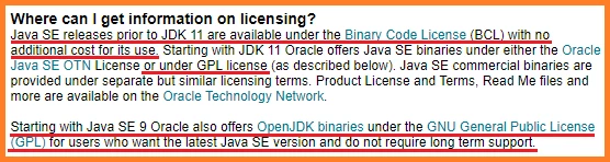

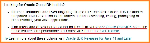

Oct 30, 2018 7:48 PM UTC
I've been trying to wrap my head around this too.  From what I can tell so far, it seems like Oracle is saying if you want support and and security fixes you have to pay for a subscription.  If you are okay just using what is released every 6 months during the normal release schedule, don't need "commercial features", and don't need security fixes or support (in between releases), then the open source version is fine.
https://www.oracle.com/technetwork/java/javase/overview/faqs-jsp-136696.html
https://www.oracle.com/technetwork/java/javase/downloads/index.html
The hiccup seems to be PTC who is stating they don't currently test their software against the open source version, they only test against the commercial, paid version.

Oct 30, 2018 7:58 PM UTC
Technically the open source build provided by Oracle IS an "Oracle Java build".  Oracle still built it but the licensing is different and no support is provided.  Sure seems like it should work...
