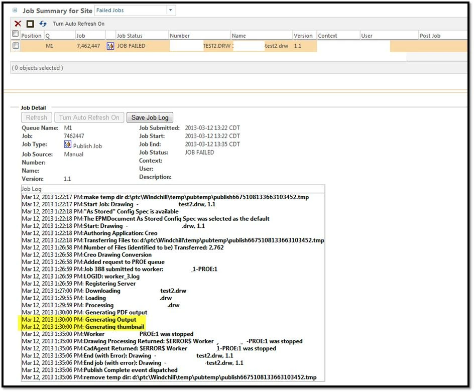

I am having problems with some of my publish jobs timing out on thumbnail creation. If I go to the cad worker, I am seeing the thumbnails but they are not making the trip to the Windchill server. In the job monitor log I get that the worker was stopped. (screenshot attached to this)
I am curious if anyone else has had this issue.
Thanks id advance.

Brian,
What happens when you try to perform this manually?

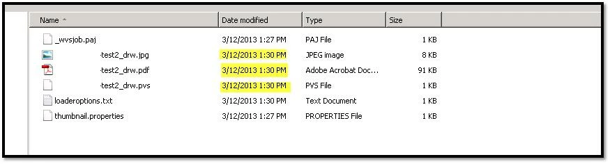

byork17-PeridotAuthor
March 12, 2013
Ray,
I don't get that and I'm pretty sure the thumbnail is fine because in the PVPublish folder the thumbnail and PDF are both there and can be opened.
Brian
March 12, 2013
The thing is that the Thumbnail is being generated very shortly after the request is made. So I'm pretty sure I'm not timing out.

March 12, 2013
Brian,
I was seeing the same message. It did not complete the thumbnail creation. Check the worker log file on the cadworker.
Mine has this:
[2013-01-21 10:48:34] Converting Author States : COMPLETE
[2013-01-21 10:48:34] Generating Output : COMPLETE
[2013-01-21 10:48:35] Generating thumbnail : COMPLETE
[2013-01-21 13:43:23] proe2pv Warning: Child lost connection to Parent
Ray
