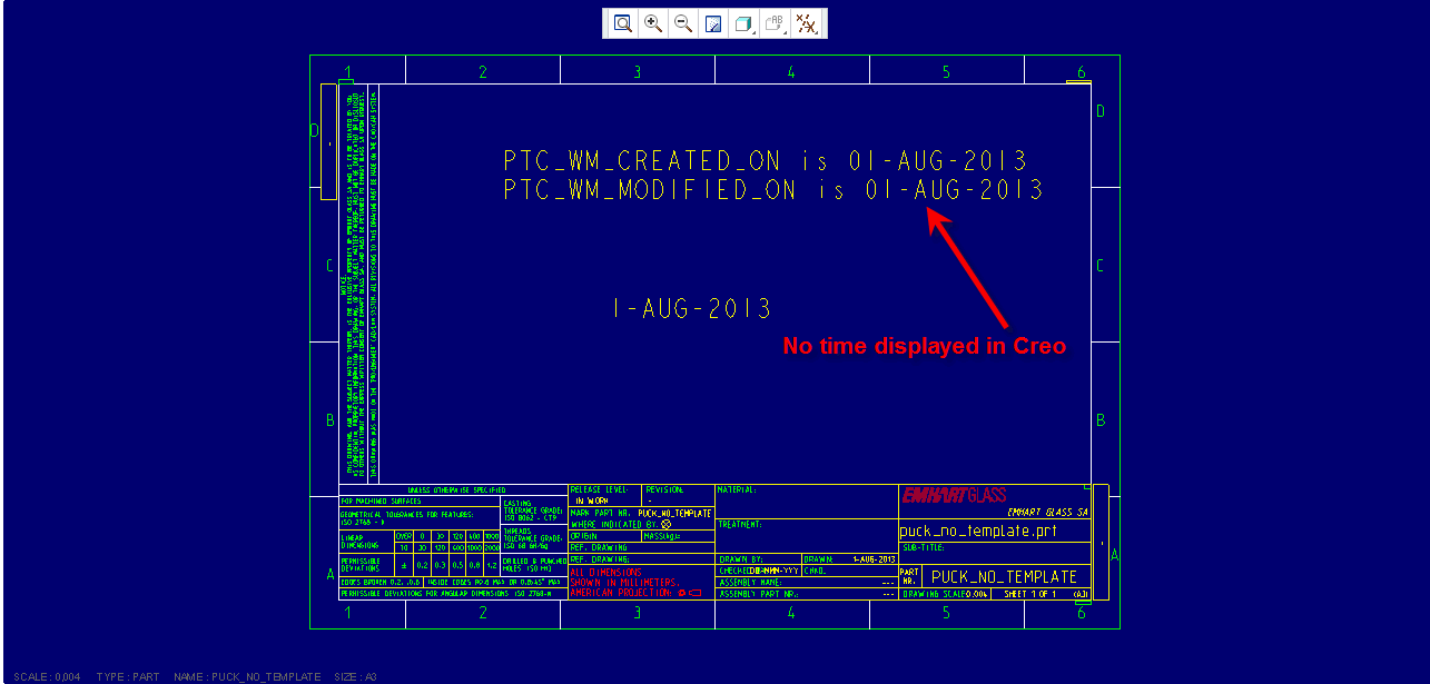

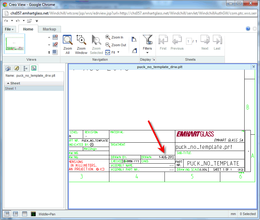

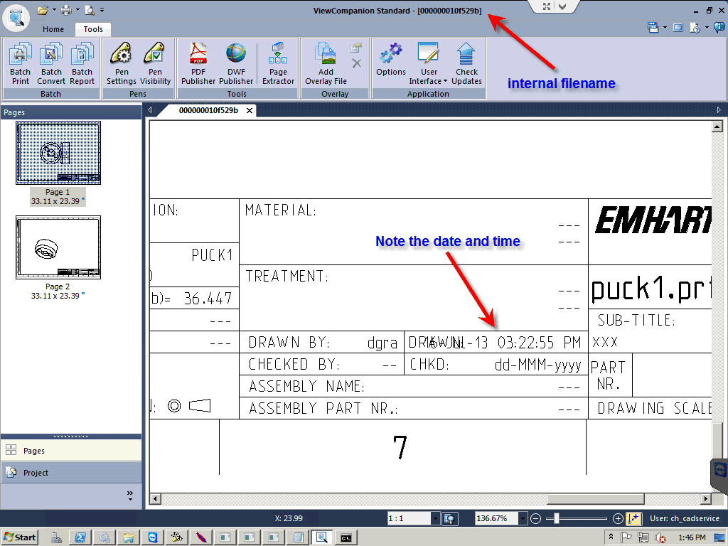

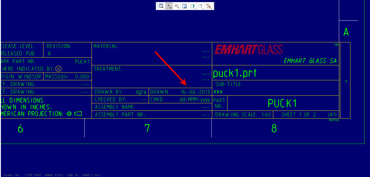

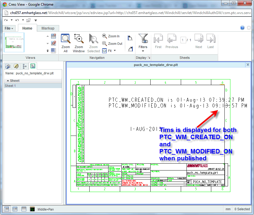

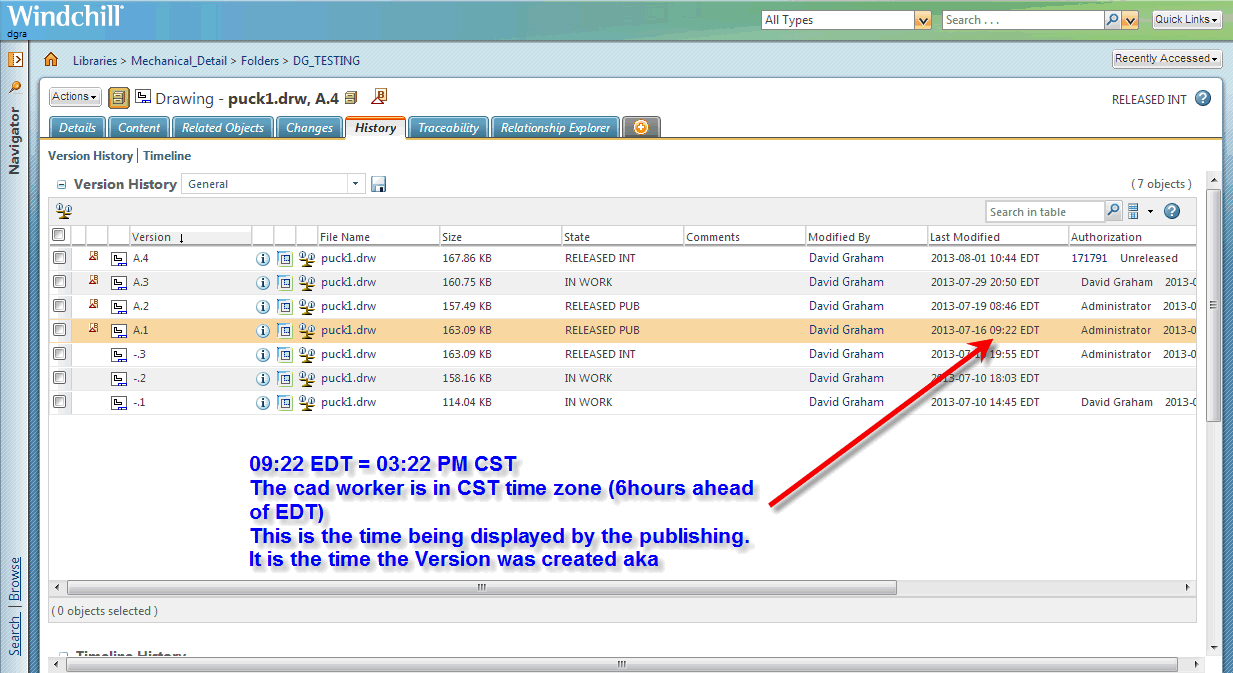

Guys,
When publishing from cad worker PTC_WM_CREATED_ON and PTC_WM_MODIFIED_ON
display as date and time.
In Creo Parametric they display as date only. See images below.
Any way to get them to display as date only when publishing?
Any setting that might do this?
Windchill 10.1 M010
Creo Parametric 2.0 M030
