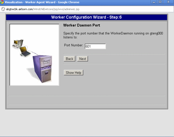

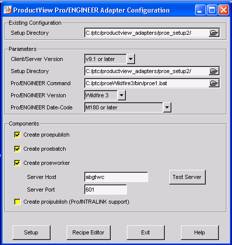

I've had a lot of recommendations (VERY MUCH APPRECIATED) and while they all seem to be great recommendations and logical, none of them seem to solve my issue so I'm down to my last resort.....reading the instruction manual for the object adapters 🙂
Interestingly, here is what it says about the Host and Port for the server:
"i. Server HostThe Server Host is the name of the machine on which the server isrunning. The worker may run on a different machine than the server.ii. Server PortThe Server Port defines the port to be used when connecting to theWorker Agent on the server host. The port number should match thePort setting defined in the configuration of the Worker Agent."
I read this to mean that settings should match in the agent's configuration on the windchill server and the object adapter settings. See attached images. NOTE: the default value in the object adapter configuration is 5600. Our worker agents are configured to use port 601 on the windchill server.
The problem is....the workers stop working when I set these values to match. So it would appear that these two settings should NOT be set to match each other. Or is it possible that after changing these settings I need to reboot the windchill server? I'm not sure this is necessary.
Does anyone else know what this means in the guide?

On 12/16/2010 1:22 PM, Michael Kramer wrote:
Mike,
This might make it a little clearer.
Port 601 is the port that the remote cad agent is running on and needs
to be specified on the Windhill side. 5600 is the port windchill
listens on and needs to be specified on the agent side.
You should at least be talking again then.
How much memory do you have on your agent machine? Is it possible it is
hard swapping? Look at your task manager on the agent when this happens
and see if you have exceeded physical memory. If you do not know how to
do that I can give you more detail.
--Bob

On 12/16/10 15:22, Michael Kramer wrote:
> Hello again,
> "i. Server Host
> ii. Server Port
The way I see it is this:
The "Worker Daemon Port" (Worker Configuration Wizard) is the port the WorkerDaemon is listening on the cadworker host. This is the port that Windchill will use to start talking to the cadworker
host. Since I am using a Solaris cadworker my worker configurations do not have this.
The "Server Port" (ProductView Pro/ENGINEER Adapter Configuration) is the port the Windchill server is listening on. This is 5600 unless you have changed it. This is the port the cadworker will use to
talk to the Windchill server. You can test the connection to the Windchill server by selecting the "Test Server" button next to the "Server Host" box. This "Test Server" will only work AFTER you have
configured the worker agent in Windchill. I have also entered a fully qualified hostname in the "Server Host" field ie abgtwc.yourCompanyDomain.com instead of abgtwc
These two ports are not the same.
