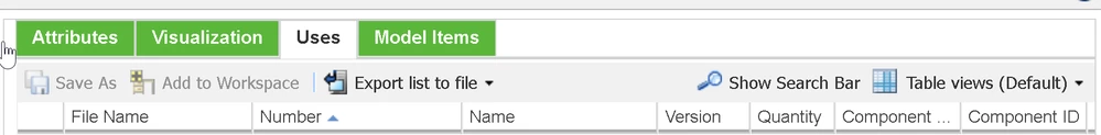

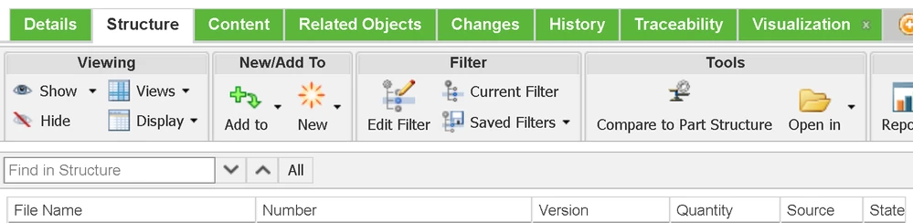

In the assembly info >> Structure tab it is possible to show the quantity.
When using SW it is possible to exclude from BOM. And here is something weird.
The Structure Tab shows the amount of each part available in the Model.
The Uses mentioned for each instance. if instance is excluded than it shows an additional note. This give (at least some users )confusion.
So here my questions
  1.  Is there a reason that both names are the same but the behavior differ?
  2. What can i do to set the quantitiy so that it shows the amount of that is also on the BOM(and ignore the excluded)?

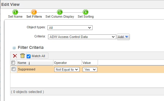

Hi @jw_CS
I have experience with similar situation with assembly family tables,
Have you check your/user's view of table?
usually user creates own new view but forgets to set the filter with suppressed parts
check the view if the filter is missing or not.
PetrH
