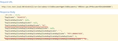

Hello everyone, please advise on how to get the format of a drawing and the number of pages in the Query builder in Windchill?
In the Reat API endpoint "PTC.CADDocumentMgmt/CADDocuments('{CADDocumentId}')", you are getting information about the format of the drawing and the number of pages.
However, I am unable to find these parameters in the Query Builder.

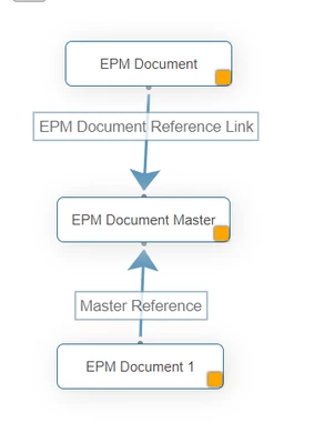

Here are the relationships that I am using in the Query Builder.

You can get the format info using linking like this:

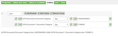

Constraints like this can further help if you only want drawings and formats:
I haven't found a way to report number for sheets in a drawing.
