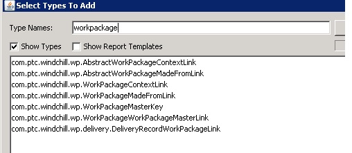

I am trying to find the relationship between the part and workpage. I have a requirement to get the list of parts on Workpackage, Workpackage number will be provided. I used QueryBuilder to get the link between Workpackage and parts on Workpackage but i did not get the expected results. What type of link is created between a Workpackage and WTPart.
In Query Builder i found these related links to Workpackage but none was of useful.

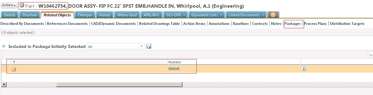

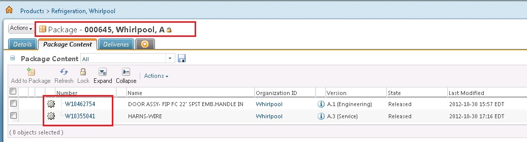

Nikhil,
The following article explains how to link betweeen a WTDocument and a Package. I believe it should be similar for WTParts:
http://support.ptc.com/appserver/cs/view/solution.jsp?n=CS131346

Nikhil,
September 26, 2014
This is exactly what i was looking for.
